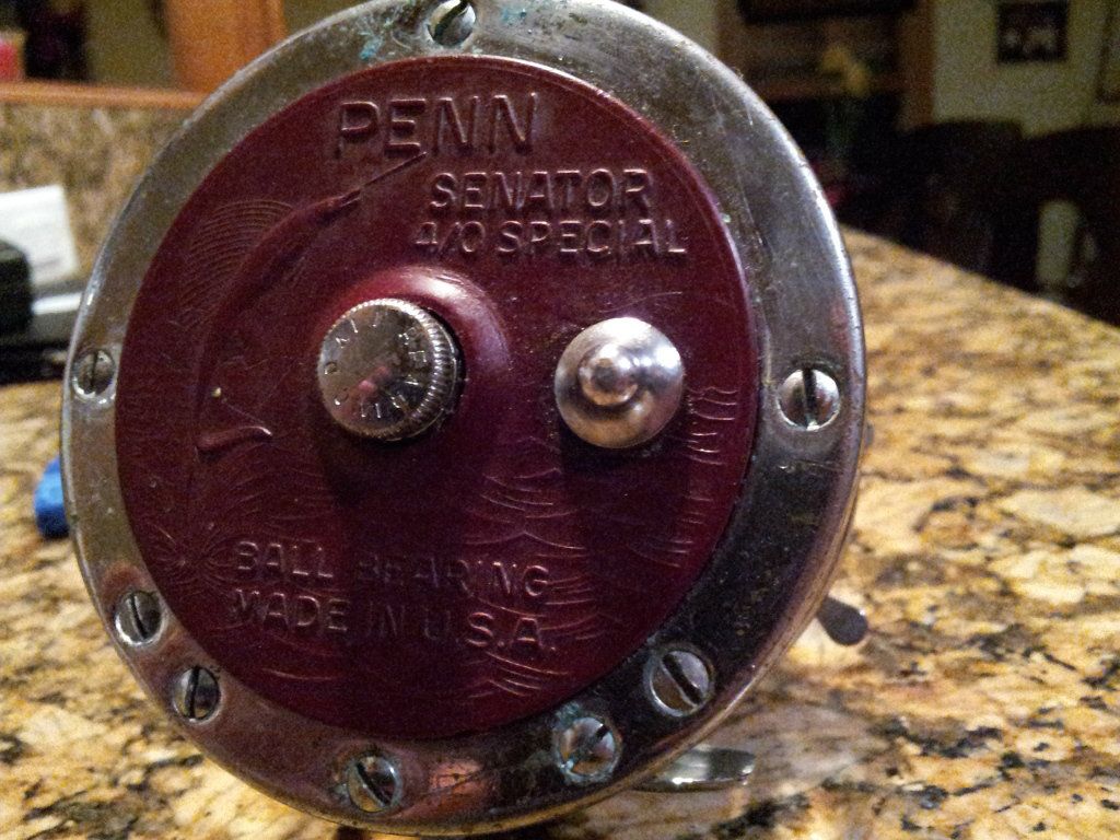

 A friend gave me an old 4/0 Senator and a couple off 500 Jigmasters
Does anyone still have a 501 conversion kit for the Jigmaster?
Here's the 4/0
If you could spare me further searching,,, is this "short tutorial" the only one on the 4/0?
http://alantani.com/index.php?topic=208.msg252#msg252
As you can see the spool was pretty corroded.
Soaked it overnight in SaltX and gave it a light touch with some sandpaper.
More to follow,,,,
