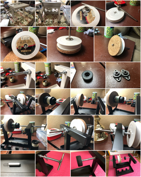

My spool winder made from an old projector stand.

Good job on the winder.....Like your choice of handle.....Bill
