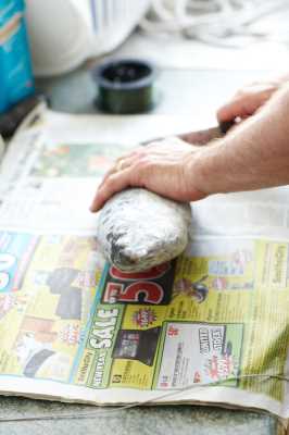

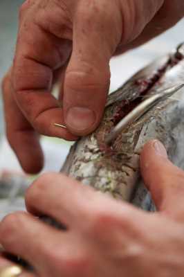

I use a four-inch darning needle, but have cut a small slit from the eye, so i can simply hook in the trace or pre-tied livebait bridle.
Once you've threaded a nice long piece of trace, put it somewhere safe for now...

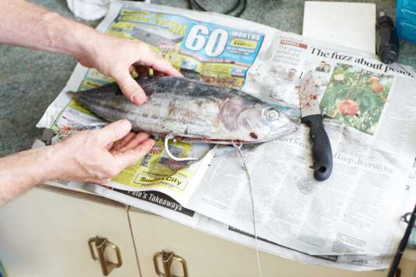

Now prepare your tuna - I've used a frozen bonito here.

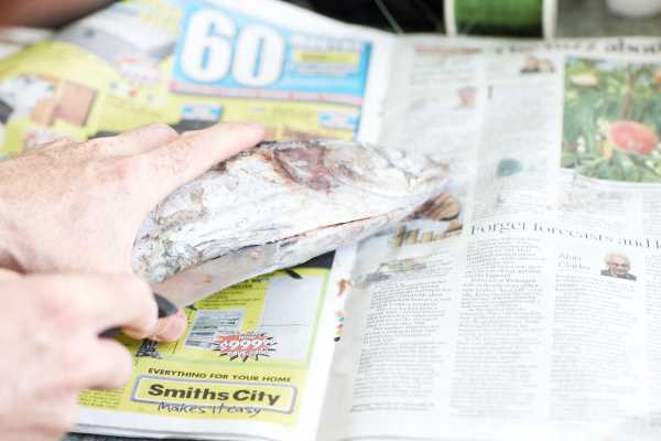

Cut off the tail so it doesn't spin in the current.

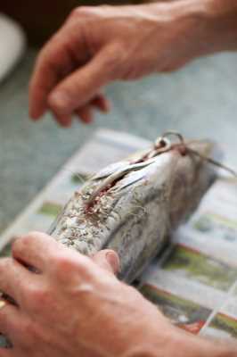

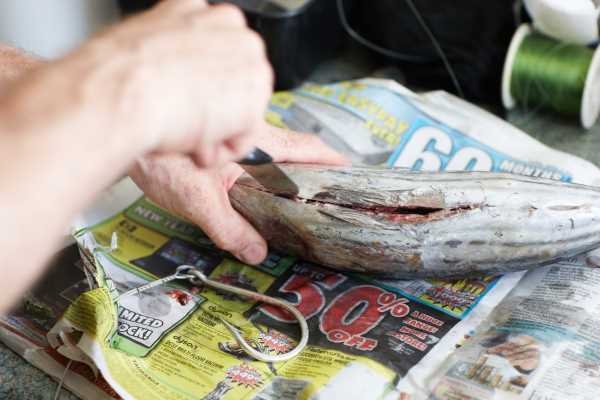

Now open a nice long slit just back from the base of the gills, through to the anal fin.
Insert the hook into the cavity and position the curve of the hook around the middle of the fish.

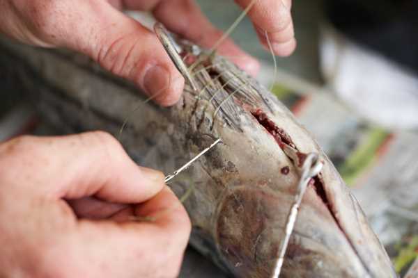

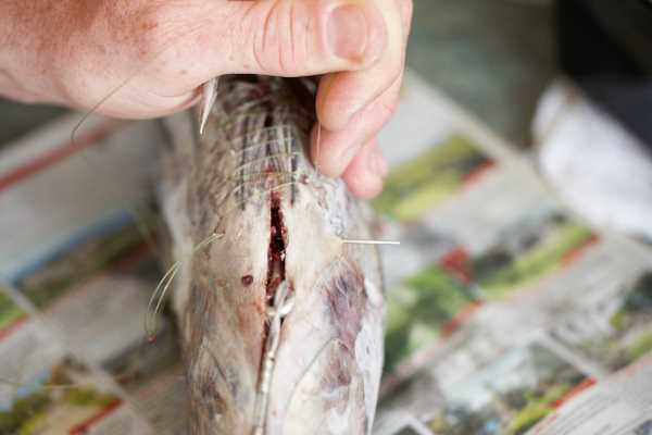

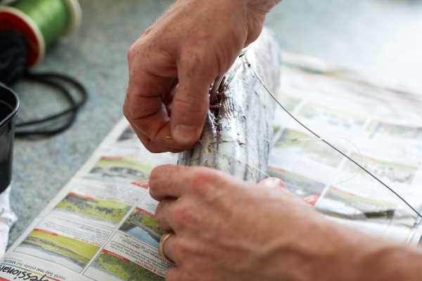

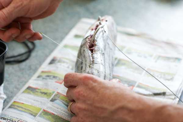

Begin stitching from the back, being sure to start with a few crisscrossed loops to form a good strong base.

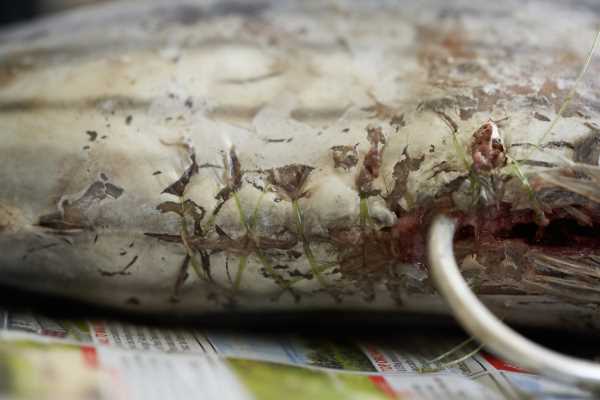

Use a standard crisscross stitch so each stitch remains tight as you move on to the next.
Take some time to get a firm seal around the hook as there'll inevitably be movement of the hook in the current.
You can see the small cut in the eye here - makes it a lot easier to weave pretied bridles through the eye sockets for live baiting.
However, since I'm simply stitching a single strand of mono, I've threaded the full eye above.
Continue stitching through to the gill plate...
Once at the gills, I use a small pliers to guide the needle through the tough plate and really fasten the top of the hook shank (ie below the eye) together with the bait.
Put in a number of loops here as this is the pivotal pressure point once the current comes on the bait.
