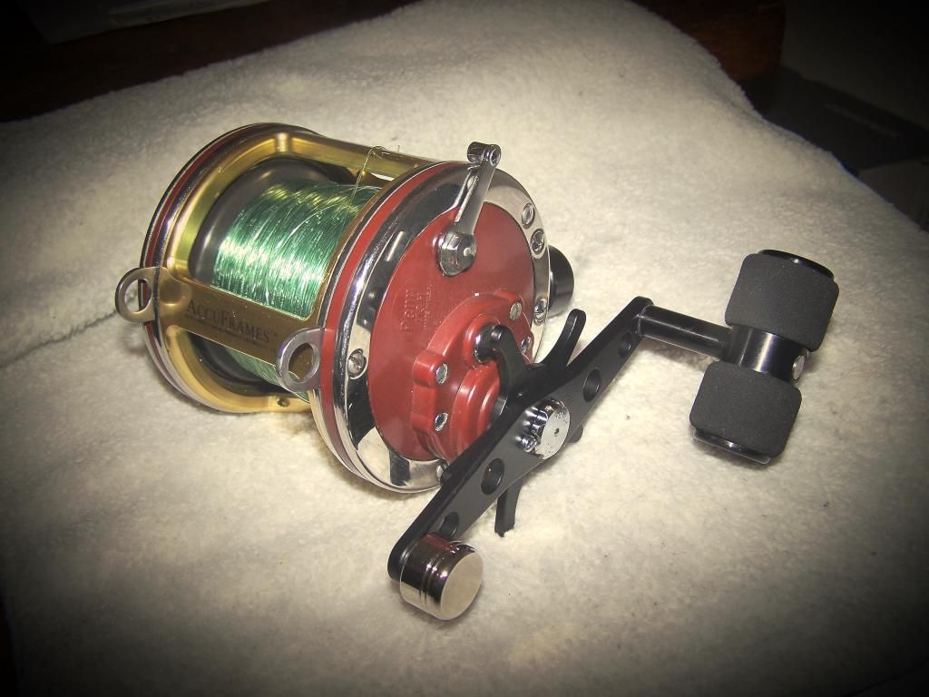

What modifications/upgrades can I do to this little reel?
RUSTY OLD COLT
ALANS SS gear sleeve , Ketas SS arm and a larger handle , upgraded drag washers and a Tiburon frame would be a good start
LowCountry
Where can I purchase all of that? What size handles?
garking84
Ss gear sleeve, ht-100 drag washers/mysticparts.com
Tiburon frames, handles/ eBay
Keta ss arms/ contact keta and see what's available

Easy boys  ;D ;D ;D This ones a gift to my son and I have all those trinkets you speak of. I'm so sick now I have a black Tiburon frame coming because I don't like the color scheme. Topless of coarse as he will be 30  ;D ;D ;D I'm going to do one for myself with all the AT website mods  ;D ;D ;D
Quote from: gatrapper on July 12, 2014, 03:19:01 AM
yeah, drags first, then a handle.  gear sleeve if you are going to lean on the reel pretty hard, otherwise leave well enough alone.  that's about it!

In the old days (12,13 years ago) -- the only thing we would need to do to a salt reel like a Jigmaster or Squidder, would be: Accurate or Tib frame, aluminum spool, upgraded drags, power handle, and the Newell plastic brown bushings in the case of a 500, 501, 505, or 506.  These would handle any 30 or 40 pound rig.
I never even put the accurate side plates on unless a client specified them -- they look good, but just get scratched up, and you eliminate the possibility of a quick change-out of your spool.  The factory plates are good enough, and they look good with an aluminum one piece frame anyway.
I had an account with Carl Newell -- and would just order his drags, bushings, and spools by the bagful.
Still have a lot of the old smooth marbled brown thin drags from Carl in bags.
But nowadays, for a good, serviceable reel -- I would just go with CF Cal's greased drags, better bushings, power handle and crank from Alan Tani & Keta, and a Tib frame.
Maybe a SS sleeve, but only if really cranking heavy loads constantly otherwise the factory sleeve is OK until it wears out.
I try to keep the cost down -- just what is necessary.
Anything above that would be personal preference based on your fishing needs.
