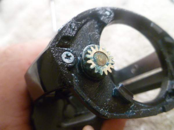

On the back side of the Side Plate is the Bearing Housing (93) held by 3 Screws (94). It also houses the "race way" for the Brakes to interact with which should be kept clean. On other reels the raceway occasionally gets a very light oiling if the brakes are howling:
The back side of the Housing mounts the Middle Gear (89) which drives the Worm Shaft (more on that later). The Middle Gear would need to be removed to get to the Click Spring (87) if required, but it was not removed for this service:

A problem I've come across with the Revo Toro line of reels (50 & 60) is the thumb bar. Tolerance wise it is not too snug. Most people when pushing down on the thumb bar push down on the opposite side of where it engages the clutch. Over time what happens is it eventually wears enough that it gets very sloppy and as a result you are pushing down on it on an angle because of how loose it has become. With all the weight pressing on an angle I have seen the thumb bar break and the piece that engages the clutch plate break. It also wears quite a groove into the frame which further loosens things up. Now muskie guys are casters and these reels see a ton of work, but it is still something you should watch out for.
Did that make sense?
What I recommend is to concentrate on pressing the thumbar on the handle side so that it is pushed down squarely (notice the wear is more on one side?). I also recommend a bit of oil where the thumb bar rubs against the frame each time you use it.
Here's a NACL with grooves wearing into the frame.

Great tutorial John
Thanks for that. I will forward this to a contact at Abu Garcia and see what their engineers have to say.
One thing is that I have gained quite a bit of regard for these reels and their meticulous molding (from every maker). They really require an enormous up front cost to introduce a new model as the frames are so complex with so may parts interacting with them in so many ways in such tight tolerance.
Therefore, it is not surprising to me that we see the small problems such as these as I am sure Abu also wanted to have good sealing in this area to avoid the sorts of trouble we see in these reels as saltwater gets into the reel around the thumb button where it interacts with the frame/sideplate. Seems they made it a fraction of a millimeter too tight but that only becomes apparent in a production reel that gets very heavy use.
best, and thanks for the post.
