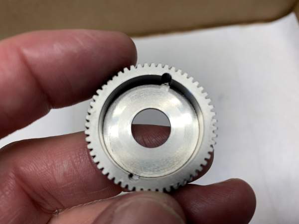

Ted,
here is the drag stack sequence from the left - Delrin washer, main gear, CF to the last metal keyed washer ontop to the most right
Here are a few photos of the ProChallanger main gear, tell me IF this is what you are looking to view???
