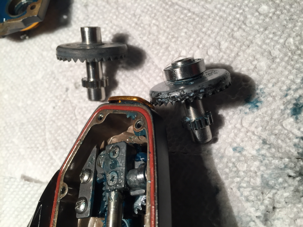

Hello,  I haven't been around the last few years because of life things, and haven't been working on any reels either. But recently I got a 4500SSV with a stripped main gear.  I figured I'd just replace the gear and I'd have a decent working reel, but I'm having a difficult time removing the bearing from the old gear.  Any suggestions?  ¯\_(ツ)_/¯
Thanks,
Bob
