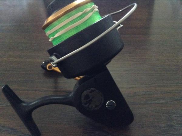

Hey guys, perhaps you've seen my other thread about the 220-F Blackie I'm cleaning up. I'm thinking of painting the seat and bars to give them some better protection and a nicer look.
It doesn't seem like we have Krylon paint over here. Would something like this work?
https://www.bunnings.com.au/dulux-metalshield-300g-satin-black-epoxy-enamel-spray-paint_p1400829
I'd prefer something that doesn't need heating. Is there any way to tell if a paint won't need heating, or how can I tell once I've painted the parts whether they would benefit from some heat?
Thanks.

I was just going to recommend an Epoxy paint, but you have already gone in that direction.
Getting all the old finish off and surface preparation, before painting, should be addressed.

I have painted several Penn Spinfisher reels with Brownel's Aluma-Hyde. It holds up well in salt water. It is available in flat and semi-gloss black. If should work on Newell parts. It is designed to refinish anodized firearm receivers.
This 710 Greenie was refinished in flat black. The 710Z was done in semi-gloss black.

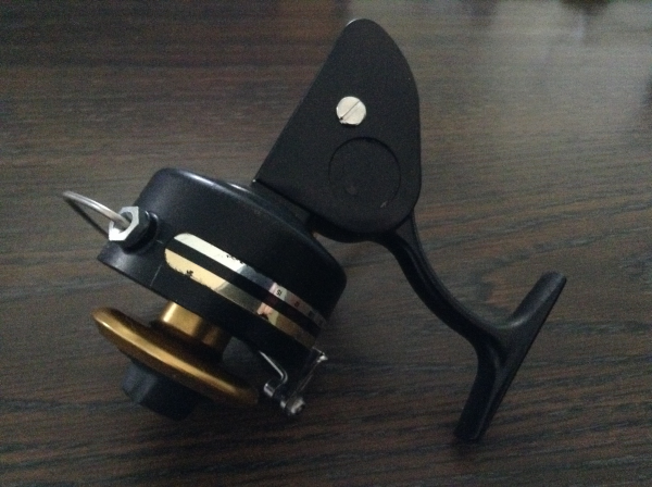

on a related side-topic.. what about the raised letters and numbers?
Any suggestions on a shiny silver/chrome paint to touch-up the numbers? And likewise, to fill-in the recessed black around it?
Not a huge issue.. just thought of it now while reading this thread.
Thanks..
Those badges will pop out from the side plate. Use black spray paint and let it dry. Stretch some fabric on something flat and put some solvent like lacquer thinner on it and rub the paint off the raised lettering, it won't take off the silver. I used some generic rattle can paint from the big box store. Learned this from Jerry(reelman). Works like a charm. Add a little glue to hold the badge back in, I used some silicone seal so I could get them out again if I wanted. You'll see 2 little "pins" sticking out of the inside the sideplate, push those pins and the badge should pop out.
