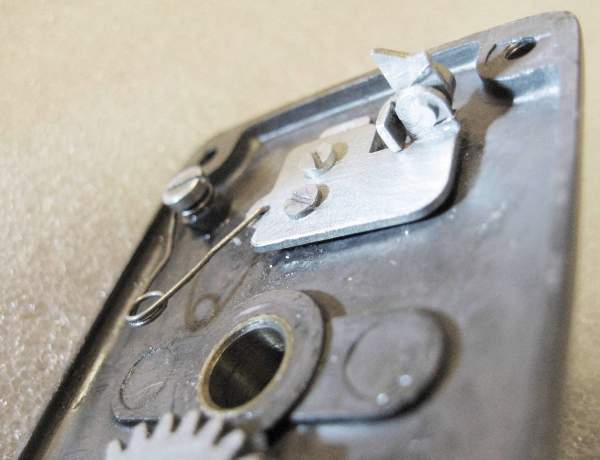

The "stopper"/click mechanism attached to the side plate.
If you look real close you can see the little springs on the A/R and stopper/clicker dogs. They're the smallest springs I've ever seen on a spinning reel, and they work perfectly, too!  :o They're so tiny I didn't have the guts to remove them.   ;D  I just cleaned them, nervously, in place.  ::)
