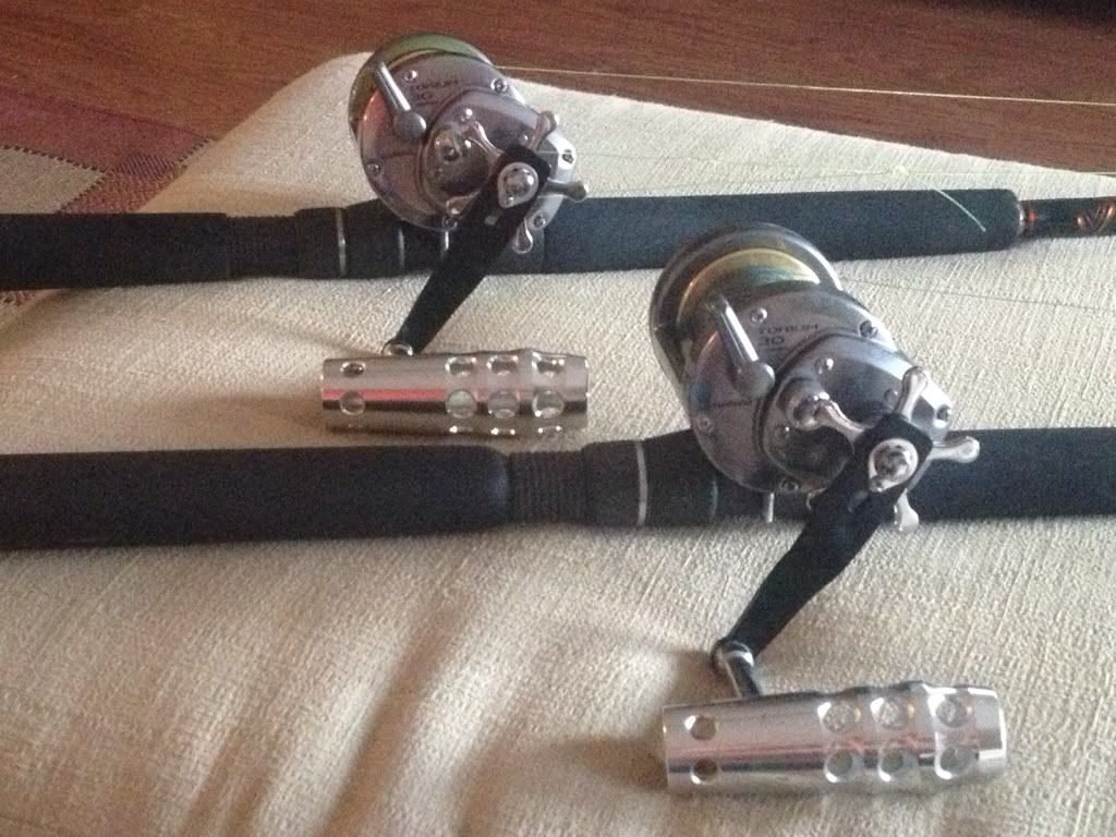

Scrappy jr.
I'm new to the forum! Alan schooled me on the Carbontex drag and anti reverse upgrade on my Toriums and when I ordered my drags and saw the jumbo Tbar I had to have them!
