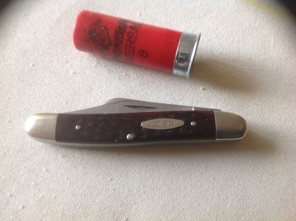

This is my everyday carry knife.
My Dad always taught me, whether out in the field, or out to dinner, or in Church -- a man should always have a clean handkerchief, a comb, two band aids in his wallet, and a pocket knife with more than one blade (in case one breaks, or is not the proper application).
Never forgot that -- old school, I guess.  But it is surprising just how many times a day the pocket knife comes in handy.
No particular reason for this knife to be a favorite -- just a combination of sentimental family memories, decent quality, nice action, and old traditional design.  Been in the family for around 70 years, or so.

Well gentleman and ladies, I purchased the 1"X30" belt sander from Harbor Freight today and set it up which took a little time but I found the one that I purchased to be powerful and very good for sharpening utility knives. I am very satisfied with it. You do have to adjust the belt support and table to allow for some clearance, about 1/16" to 1/8" As far as I'm concerned it was a great suggestion.
After setting up the belt sander Ruth and I celebrated with a bottle of Chainti Reserve 10 year old I had one large wine glass and some cheese and Peaches. Ill be honest, it's a wonder I am able to type on the computer right now ;) ;D It's been a while since I have drank any wine so I feel pretty good right now..thank you! Fred I have a pocket knife like that made by Remington with the choke blade for changing chokes in you shotgun and a punch for making a hole in a turkey leg for as tag.

#25
Beautiful knife, Joe --
