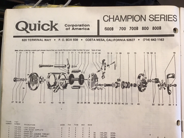

mark Hill
Does anyone have schematics for the DAM Champion 700b? The anti-reverse dog appears to be 2 separate pieces and requires no spring?? How do you think these reels stack up against the Garcia 5000's... seems to be the typical DAM quality.  PS, I hope you are all doing great in these crazy times!

Mike's right -- excellent reels.  Just as the ABU's are.  Daiwas are also similar -- probably slightly lower in quality -- but tough to notice the difference.

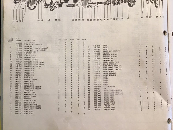

Here is a quick schematic and parts listing.

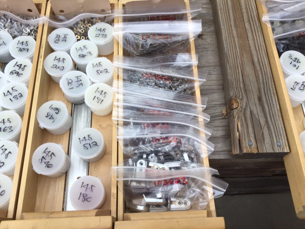

I have most of the parts for these.  They are the 145 numbers.

So what's the difference between the standard and the "B" models?
Just color?  Or gear ratios?

mark Hill
Fred, I have a bunch of ABU's, Presidents and Millionaires but this is my first Quick. The Quick will get a good workout and comparison test after it's together...going to be a blast! If I need ANY parts for this reel I will let you know... You're thee guy. I believe the differences are narrow spool models?
"Sell a man a fish, he eats for a day, teach a man how to fish, and he will start collecting and refurbishing old reels"
Yeah, there are narrow and regular width's in the 600-700-800 models.
To answer Chads question -- the difference between a regular model and a "B" model is that the "B" has bearings -- the regular numbers have "slide bearings" -- (sleeves).
Both are very good.
These are some of the toughest bait-casters around.  You won't likely need any parts -- unless something has been tweaked or distorted.  And with the exception of springs -- most parts can be put right back into service with a little adjustment.
