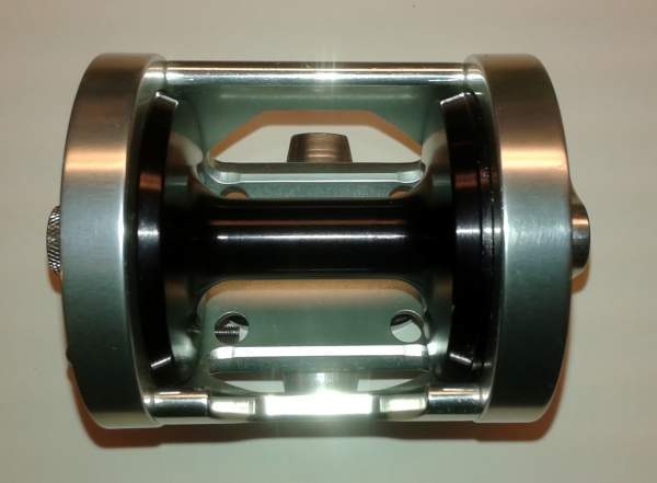

Thank you Al. Your excellent write-up has inspired me to get motivated on my own Magnum build which has been stalled too long while hunting parts. I'm now far enough along that I can see light at the end of the tunnel and finally have my frame and spool assembled. I noticed in your photos that it appears that your spool might be off-center to the left. Is this an accurate observation on my part? I'm wondering if this is common for the 500 Magnums as I'm having the same issue. I want to gather as much information as possible before proceeding. My spool sits to the left with the right side flange about even with the right sideplate (non-adjustable) and it sits deep in the left sideplate which is adjustable. I don't have a bridge and gears in here yet because I'm holding out for the stainless bridge before I do any fitting. I do have the spool and frame assembled and the spool spins true with great free-spool but I'm concerned because the spool isn't centered. I think that it could eat line up to 30 lb. mono on the right side but not the left. From the side of the spool flange to the side of the sideplate is a 0.002" gap; around the circumference the gap is greater. I would really appreciate any advice from the experts here. My first thought is to machine the right side bearing pocket a little deeper to allow the spool to center on the frame but I'm concerned that this might move the spool too close to the bridge for the pinion to fully disengage. I'm hoping this team of experts here will have some good advice. I'll wait until I'm certain that this would be the right fix before altering any of the rare Magnum parts.

I noticed in your photos that it appears that your spool might be off-center to the left. Is this an accurate observation on my part?...  I do have the spool and frame assembled and the spool spins true with great free-spool but I'm concerned because the spool isn't centered.I'll wait until I'm certain that this would be the right fix before altering any of the rare Magnum parts.

I just noticed mine is the same. Hmm. Maybe the spool shafts are a little long?

It's the drive side (right side) is where the problem lies.  it's pushing the spool too far to the left.  Not sure if it's the cup not being machined enough or an error in the spool shaft length.

I don't think knocking down a little on the tip of the shaft would help, I'm thinking the problem is with the shoulder on the shaft...too tall

Sal, You are correct about taking the shoulder back a little. I don't think there's a problem with the tip of the shaft.
I agree with you guys but I'm holding out for the PC stainless DD bridge and gears before I do any modifying of the spool or headplate but if I were to make an assumption; I would say that the headplate bearing cup should be slightly deeper. Unless...there's a fitment issue and Accurate knew this when they designed it to allow more room for the drivetrain. Maybe they figured no one would spool it with line that could fit through there? There's evidence that shows that this is not totally uncommon. For sure Al, Bryan and myself have reels like this. Bryan, I'm assuming that you built your Magnum from parts like I did. Al, did yours come from the factory that way or did you build it? I'm asking because I'm wondering if the factory had a solution for dealing with this or if it's by design? Even the factory assembled units could be considered semi-custom.
My own thoughts are to either bore the bearing cup a little deeper or as you guys have suggested or modify the shaft. Either mod can then be tweaked to perfection with shims and the adjustable bearing in the tail plate. I feel that modifying the shaft may be easier with simple tools (drill-press and file) but a screwed up spool is probably harder to replace than a headplate. My spool was the last major component that I acquired and it kept this build on hold for a long time. The bearing cup is 3/8" or 0.375" dia. but I would want a tool that only cuts on the face (maybe Tom could comment on this?). I was thinking of using a four flute end mill with the cutting edges of the flutes dulled on the sides so that they won't cut then cutting it by hand with a holder like a tap holder or hand-turning the end-mill with a drill-press. The thought of boogering up a head is no bueno.

I just checked mine.  The spool is centered perfectly on my squidder.  On one jigmaster the spool is also centered perfectly.  My other jigmaster the spool is very slightly off centre the same as we're talking about here, but mine is maybe 1/32" off centre and there is no line eater gaps.
